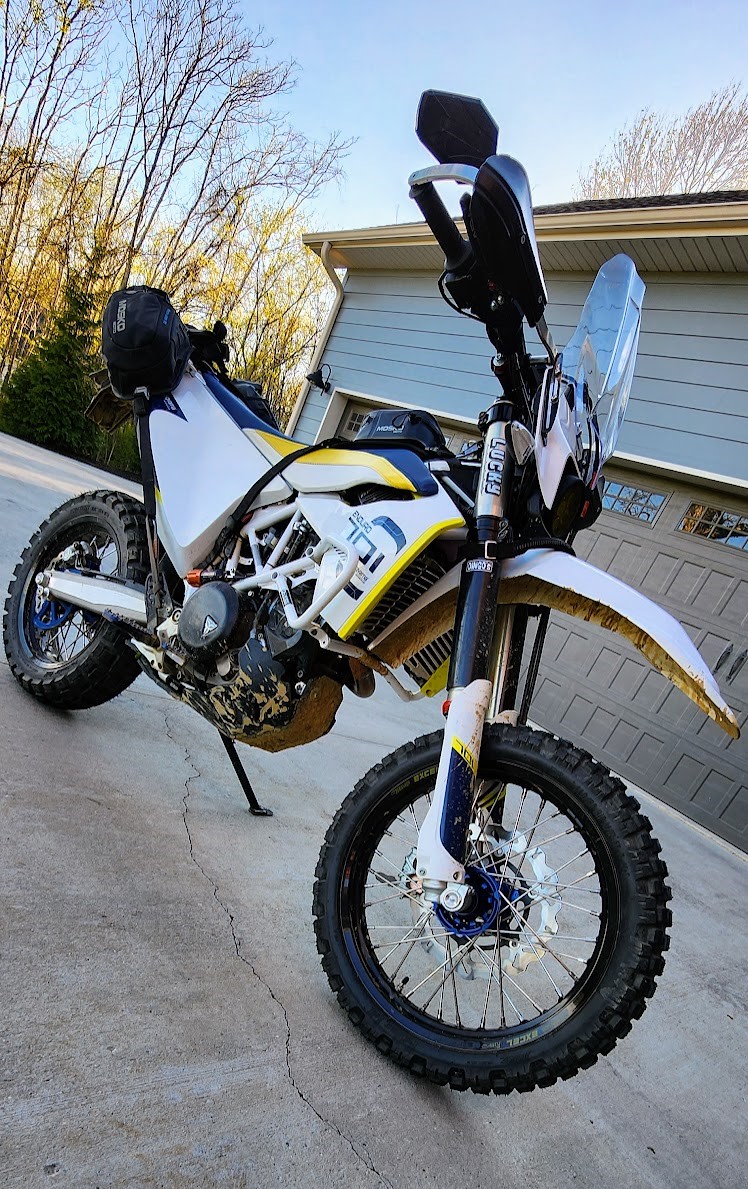

Woody's Wheelworks in Denver Colorado builds wheels that match BMW GS sizes. I installed a pair and like them a lot. Frame geometry did not change, just lowers the bike about 35mm. These are NOT SuperMoto. 19 inch front and 17 inch rear. I'm running MOTOZ Tractionators: 110 in the front and a 150 in the rear. Handling is not that bad. I took the bike into the woods today and it was just fine, but the ride did feel a bit more harsh than with stock wheels and these tires don't bite as well as my Pirelli tires. The beauty of this setup is that I'm now tubeless!! I don't have to carry extra tubes and wrenches, and tire spoons and it's much better on the road.

Thats an interesting Wheel Combination. looks very good
Which size did you take ?
I'm considering trying this combination
Front 19x3 Rear 18x4,25

The rim sizes are:
Rear: 17 X 4.25
Front: 19 X 2.50
