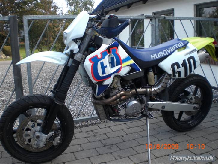

Does anyone know the oilpump installed on this 610 TC engine??
I would really like one!
Feel free to answer in german :D

This engine has no oil pump, besides the engine is at 1999.
Since 1999,where a small oil pump was installed for the conrod.
Any questions???

bei dem abgebildetem mopped ist eine elektrische nachgerüstet und darauf bezieht sich seine frage.

jodi hat geschrieben:bei dem abgebildetem mopped ist eine elektrische nachgerüstet und darauf bezieht sich seine frage.
Ahah und woher weist Du das? ;-)
War mir aus der Fragestellung net ersichtlich. :-?

..weil Menschen Augen haben. Davon ab is es ne 98er.
As said above, this oilpump is a custom-made item, and in that construction not available on the regular after market!

Are you sure it's electrical??? Do you know which pump it could be?

elektr. Ölpump ??? I can`t see a elektr. think !!! The pump ist control by crankshaft. The left motor cover is from Bj.incl.92 with the little clutch. The Dealer Jola have bmade this System in the middle of the 90.

it looks like the oilpump from my honda cb 550. it`s no eletrical pump. i doesn`t look correctly.

So this is an aftermarket system made by Jola.... or???

Years ago I saw also a Oil-Pump-System for the old 610-engine.
But I think its not woth the money. The 610-Engine (the old Engine, we call it "Dino") has Ball-Bearings. As long as theres no forced feed lubrication the Oilpumpe only spits the Oil to the Crankshaft.
So I think the this oilpump (and so oilpumps build in at mj. 1999 and above) are only good for one thing: A quiet conscience.

Can you show as the Part between the Alternator and the sprocket? The picture ist to small to see the oil-line.
